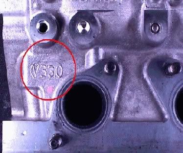

The 2.0Tdi early engines - with cylinder head numbers v330 v320 v125 v130. The heads crack, and its seen with a loss of coolant. Replacement head needed
